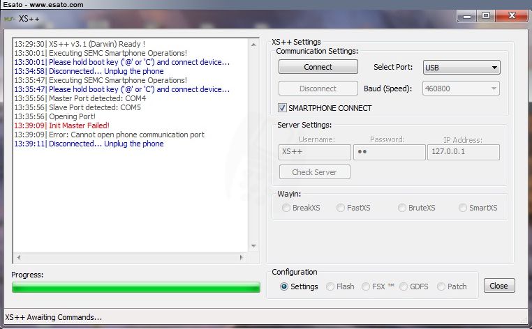

harshahiriya Joined: Jan 14, 2010 Posts: 3 PM |
it is showing like this.
What is the problem? |
ryuriel Joined: Nov 27, 2008 Posts: 124 From: Philippines PM |
1. Turn off your phone
(remove battery and place it
back) and run XS++ (!!!without
SIM card!!!)
2. Tick ‘Smartphone’ and click
Connect button
3. Press and hold on ‘C’ button
on phone and then connect
using the USB cable
4. Wait until it finish detect
your phone (show with some
green texts)
5. Smartphone Flashing:
Browse your resurrection
package (!!!DONT EXTRACT!!!
Browse ZIP file)
6. Tick ONLY Flash CCPU
7. Press Flash PDA
8. Wait... when you see
Disconnected... Unplug the
phone
9. Disconnect your phone, and
DONT TURN ON!!!!
10. Update your phone via
SEUS again
