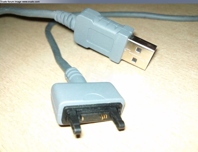

I tried those links and still no luck. Same results. Could it be that my cable isnt the compatible one? I had my phone updated via SEUS using that cable but I know that SEUS and modding requires different drivers so maybe its the same thing for cables?
It has connectors like a DCU-65 but it doesnt have magnets on each end, and its grey.

i've mod my acoustic, camera (sometimes), layout, add some flashlite menu, change setting menu to tabbed view like old stle one and i didn't notice any problem there. There's nothing problem with your cable dude, we used same cable here.
