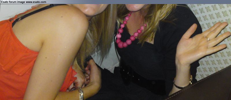

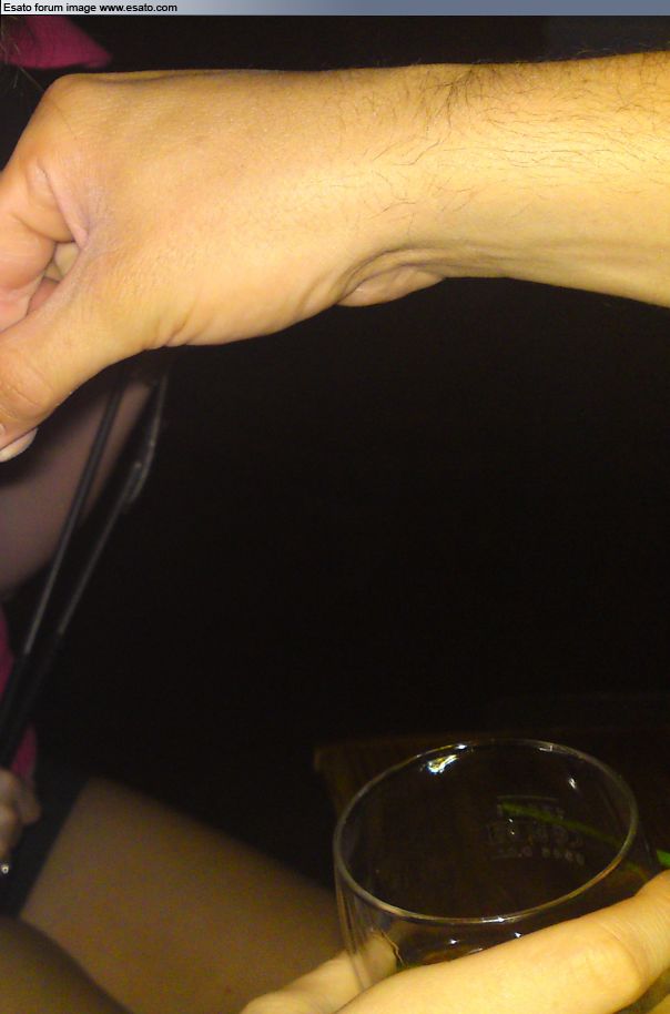

@ardzuna - I have cropped some pictures as I didn't want to upload pictures of people without asking them, but they show the skin tones being yellow and the people definitely aren't these colours...
