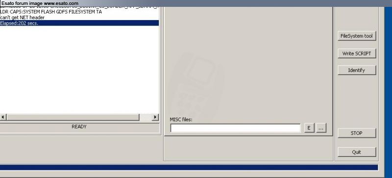

vodanh Joined: Feb 25, 2009 Posts: 24 PM |
i get this
when i run the a2uploader.
and hold C on the phone as i plugged in
i remember i have backup a copy of my original FW. hope i still keeps it at home
see if i can try it when i get home.
but for now. a2uploader can't read the header.
wonder if i can force it onto the phone. or do i use the SEUS
