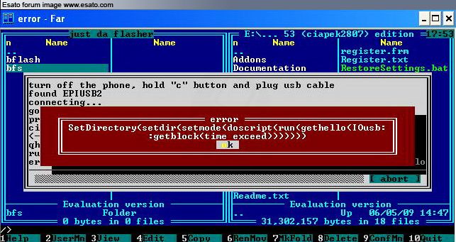

I want to flash & apply patches to my K800 R8BF003_RED53_WI.
When I connected it via FAR it displays:
1. qa 2020
2. bflash
3. After clicking "bflash" after sometime the error appearsas follows:
SetDirectory (& a long detail after it..........)
This is the dead end & I've to plug out the phone. My phone is not working at all & even I'm unable to re-flash it.
If u have tips about it, i'll be happy to see.... thanx

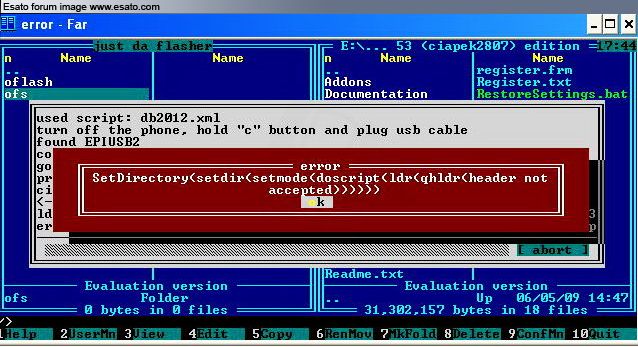

When I connect via FAR & click on ofs, the error appearsas :
I cant think what's ahead....!! Thanx for any assistance.
And when I click after entering "qa2020", the error appears as:
[ This Message was edited by: rsdsgd on 2009-06-12 12:57 ]

Firstly you are using the wrong script. You should be using db2020 not db2012. Second qa2020 is only used after you have patched QAPatch.
[ This Message was edited by: Boysie99 on 2009-06-12 13:44 ]
