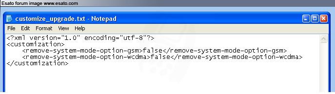

I was having a look at Default.xml of a few phones and I remembered that selection of "3G Only" (or HSDPA Only) was removed in newer W910i firmwares.
I took this from a the C905 default.xml. Do you think it will add "3G Only" to network selections on W910?

For adding HSDPA only option
EDIT: the forums disable html option doesn't seem to be working correctly so I cannot post the customize_upgrade.xml (I'll upload it to sendspace and add a link in a little bit)
EDIT_2: upload customize_upgrade.xml to tpa/preset/custom and it "should" enable you to select HSDPA only option, but it doesn't work when set anyway (tested with K850).
http://www.sendspace.com/file/spf1sw

Whenever I put a customize_upgrade.xml, the phone will show the Please Wait... for a couple of seconds and then the phone starts. But there is no changes at all. Should I reset the phone for changes to take place?
