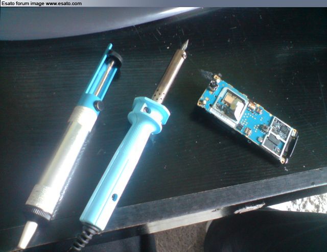

Hello to all, i am just asking if someone know how much powerful soldering iron needs to be to burn off some part frome the phone, like it is joystick on k800?
I got one soldering i. which have 40W, but its impossible to burn off something from the phone. Please i need to know this quickly.

u need only 20 watts with good soldering tip and a good soldering lead
chandu17 Joined: Apr 24, 2008 Posts: 344 From: Andhrapradesh,india PM |
How much powerful is does'snt matter. u need soldering rod that is used in repairing television sets.
i.e it should have small soldering diameter.

Will looks like it's impossible to make it with this tools i think i need a little more professional tool

razec Joined: Aug 20, 2006 Posts: > 500 From: Pearl of the Orient Seas PM |
you need a little small soldering iron because the more intense heat produced by the one shown in the picture could melt other components surrounding it. you also need a thinner soldering lead for that job.

aquared29 Joined: Dec 07, 2008 Posts: > 500 PM |
a soldering lead with 60/40 ratio lead, a shiny lead and a soldering paste for cleaning your soldering tip and a cork where to wipe your soldering tip

Will thanks guys a lot of for explains, i am going to find some better soldering iron on ebay. |
StevenC Joined: Aug 23, 2008 Posts: > 500 From: NY PM |
I'm used to soldering. 40W is a bit powerful for soldering modern electronics.
You will also need a thin and sharp tip to solder correctly.
