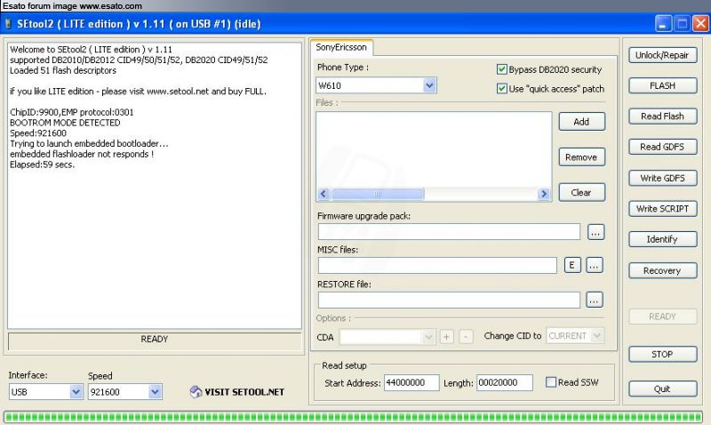

im getting this error when i plug my phone while pressing 2+5 and press repair on setoolslite. what do i do now ? :-S |
own_rulz Joined: Oct 21, 2007 Posts: 10 PM |
now i got a new error screen while using repair tool on setoolslite on bootrom mode..please have a look and help me out..... please...
