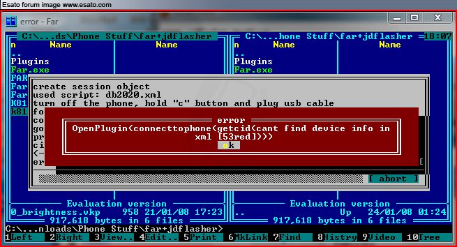

golemsmate
C905 Black
Joined: Nov 09, 2007
Posts: 442
From: United Kingdom
Posted: 2009-03-24 19:11
need a little more help when i try to connect my phone i get this picture? Is there a step before? I dont unserstand the tutorial that well lol
