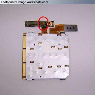

It happened to me when i replaced the cover on my K850 too.
I removed the cover again, cleaned the keyboard conctacs with an especial cleaner (dont know the name) and conect it again, the 1st time it didnt work so i tried again 2 times more and it worked.
Try that and be careful with the part of the keyboard that is on the side (camera button) because it can lose it (fall) very easy and the only way of resolve that is replacing the entire keyboard (happened to me also )

Hi thanks for the reply. What do you mean it can 'lose it'? Like it breaks or something?
It seems to be very random sometimes it reacts when the back cover is pressed and just now it reacted when I pressed on the sides.
I've not actually managed to remove the back cover yet but just tried to remove it next to the buttons, so you think that I may have damaged the keypad bit (you showed on the picture) when trying to take the cover off and that I need to buy a whole new keypad? Is that right. And lastly, when you took the back cover off, did you remove the screws in the battery cover? Because I skipped that part as I though it held in the front cover. Thanks for the help
