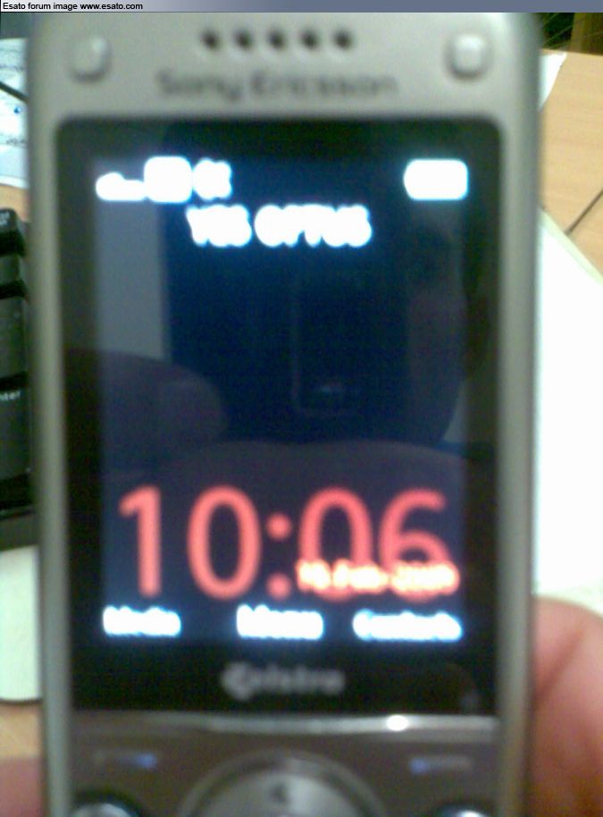

i have a W760i and in the menu selection, i've chosen to have the clock displaying large numbers.
Is there any way of moving the clock to the middle of the screen because when the clock is displayed, the end digit is covered by the date.
I've attached a picture.
Thanks

U can do that by editing the layout.xml (found in tpa/system/layout) by yourself or by using Mr T's SELE.

Thanks for your reply.
All sorted out. It worked a treat.
Now the clock is in the middle of the screen instead of the bottom.
