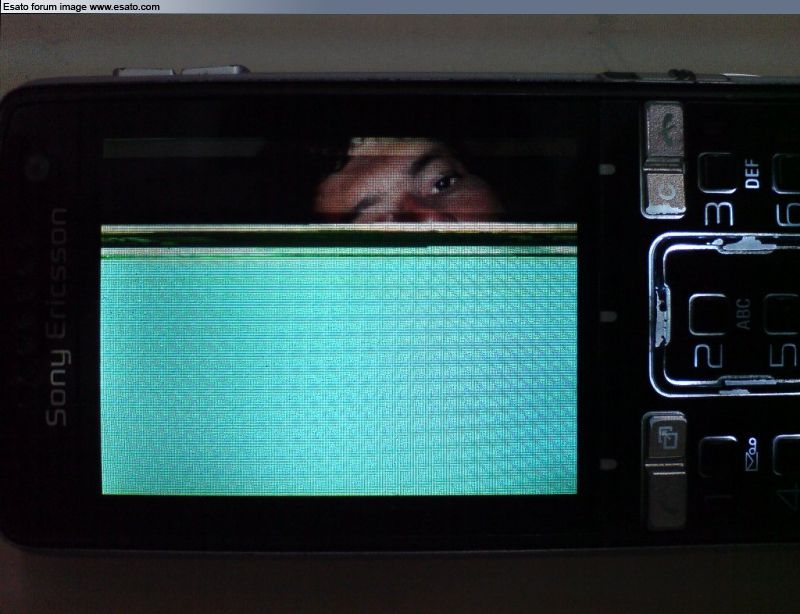

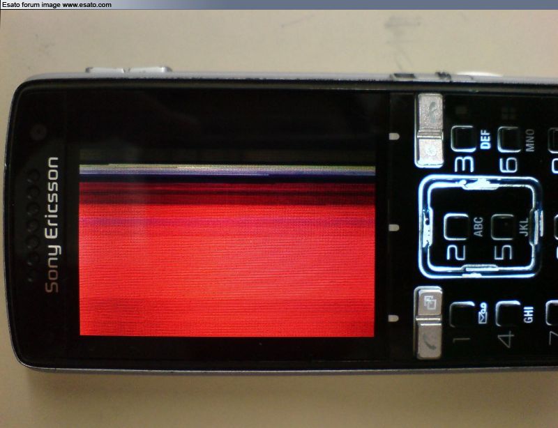

Hello. I cannot watch pictures horizontally on my K850i. Just the vertical position shows them correct. I dont know, but when I turn the phone horizontal to view pictures they start rendering correct but after 20% they just show nothing but scrambled images. I already reformat and reflashed the phone about 5 times, trying different firmwares but nothing fix the problem. I bought this phone from ebay and the guy said the phone was working properly . Anyone has a clue on this ?
I have pictures of the problem below:

Just to add more information on this problem.. I recorded a video of 2 minutes and I can watch both horizontal and vertical and it works great.. so, the problem is just when viewing pictures...  |
