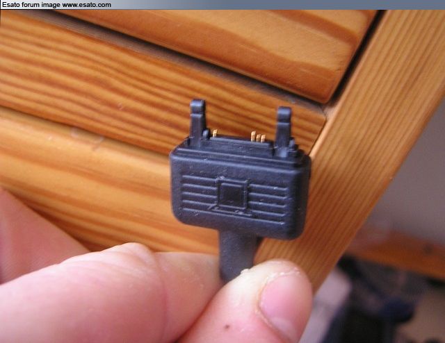

Posted: 2009-03-01 12:18
This is my cable: Only 4pins as you said. SO I guess I should get another cable. Is it so?

Posted: 2009-03-01 13:05
Yeah, make sure current is supplied via pin 12
http://pinouts.ru/CellularPhones-P-W/se_k750i_pinout.shtml

I guess the problem is solved (or rather "Will be solved") - I'll try to get the correct USB cable. It's pity that SE's original cable misses this pin.
