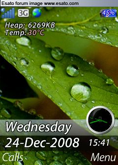

How did you get the day,date and clock time like that on your main screen,is that what an elf can do?? is it rite that i need a memory card before i can install elves?...rga
P.s how do you take a screenshot of your phone,had a rite gud read around but to no joy,heard an elf is only way?
[ This Message was edited by: reggaedave on 2008-12-27 13:06 ] |
yes, those are elf's. you dont need much memory for this. these files are not big.
