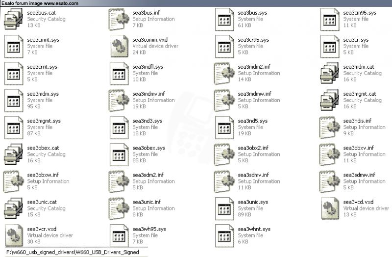

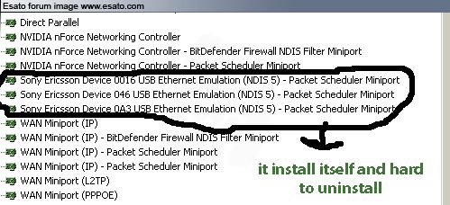

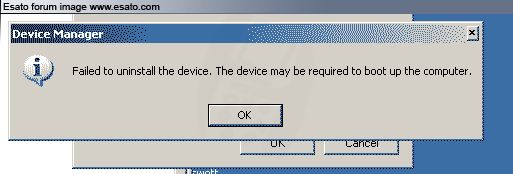

i have k610 flashed to w660..i dont have system restore so i cant use it to uninstall all drivers of w660....its deleted all now...dont ask me how..3 hour job..but when i connect my sony w660 to pc ,problem is that it doesnt ask me to add new hardware ,but more,it recognize it by itself and it put some USB Ethernet stuff in network adapter(system device) which CANNOT BE UNINSTALLED....it says i cant uninstall ,because of it beeing a boot device...PLEASE tell me WHAT TO DO to completle remove all drivers so i cant start over with connecting my sony to usb port and install only drivers for copy and delete files from sony to pc ...i dont need ethernet or modem....and as i said it is very hard to uninstall that...and i need to reinstall every time again and agin because my pc autodetects sonyericcson...when i connected my sony ,3 months ago,for the first time, it didnt go that way....so how to go back to that state....please any expert reply to me.so that pc asks me to install new driver for new hardware..thanx!!! i also have the picture of the driver for w660 i used...

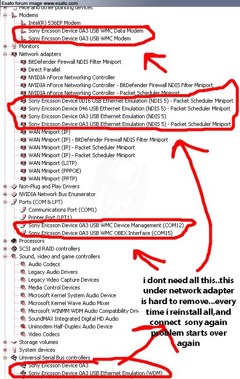

well here we go again..when i install downloaded PC SUITE..ut installs all that crap on the picture..i just want my phone be able to copy/delete files ..and charge battery....anyone ,solution..now i must see if i can uninstall all the crap againg..maybe itl took me one hole hour...registry and stuff!!!! HERE WE GO, PACKET SHEDULER MINIPORT,usb ethernet emulation (NSID5) cannot be uninstalled...after uninstalling PC SUITE...plese give em some suggestion!!!

Disconnect your mobile phone from usb and do this:
Create a system restore point as a preventive measure.
1. Go to Control Panel > System
2. Click 'Advanced' tab and then 'Environment Variables'
In System Variables create a new value using these information:
Variable name: DEVMGR_SHOW_NONPRESENT_DEVICES
Variable value: 1
Click OK.
3. Now go to Device Manager, click Advanced and select Show Hidden Device.
Now try to uninstall the drivers.
hope this helps.
If you can't uninstall using the above, then you can still use Autoruns. It will delete the driver from the registry and subsequently you should delete the SE driver files from C:Windowssystem32drivers
Make sure you create a system restore point before you proceed.
