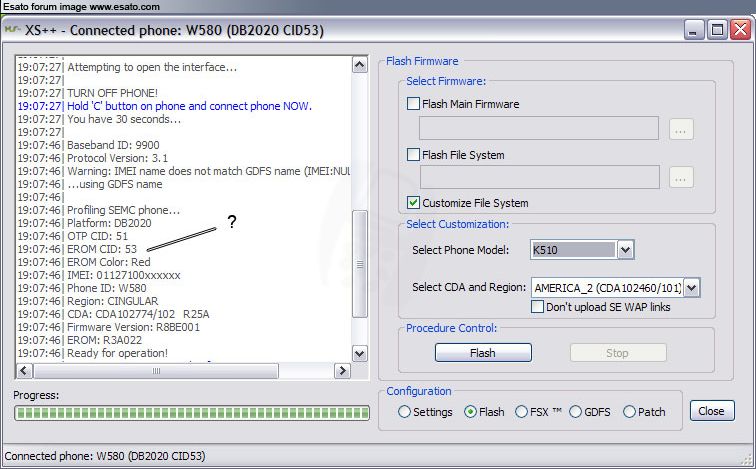

Revtek Joined: Dec 17, 2008 Posts: 6 PM |
I found out I have CID53... Where can I get the other tools to load main and fs for my type?
Here's what it shows when I tried XS++
I was reading some posts and found that the Sony Updater might have updated my type from CID52 to 53... I wish I knew that before I used their update service. =( |
yes
SEUS is upgrading to CID53. Be careful! || Jdflasher a solution || can't apply patches
