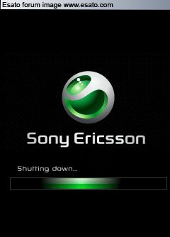

Can some one tell how to change START UP and Shut Down Animations ! |
firoz3321 Joined: Aug 29, 2008 Posts: > 500 From: AP, INDIA PM, WWW
I know that these topics are discussed before ... but cant really find the exact topic ..
I have k800i with cid53 R8BF003 firmware. I cant patch my mobile.
I want to change the default start up screen ..... not the one from the settings//display//starrup screen/
I want to change the inbuilt screen !!
Hope u get it ... |
