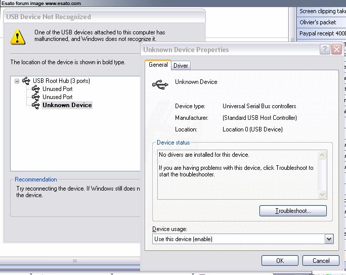

I got myself a P1i off Ebay. l love the phone very much. But i think i messed it up or something like that. I have done a reset and did not know that some applications will be wiped. Up to here, no big deal. Then i wanted to reinstall a new firmware; then comes the problem. MY PHONE CAN'T CONNECT to my PC. (Or it does) But the PC says Not recognized USB device. Is it the same for my 2 PC and 2 Laptops (Xp and Vista). As a result, SEUS doesn't work. I have already tried everything i knew could help.

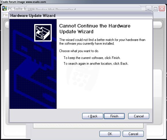

I've tried (without success) all the options you have suggested. Uninstalled, restarted, reinstalled newest version, restarted, changed cables and ports (both on my PCs & Notebooks). The drivers doesn't just load. Tried to update by searching automatically in the Net; No success.
Meanwhile, my gears recognize and synchronize our K800i (2 of them). I tried also with SEUS alone. It says to off the phone, extract and reinsert the battery, and to plug the cable while holding C; and that is it. After a while it says to start the process again. (Meaning it had no contact with the P1i).
Once plugged, i always choose phone mode. (Anyway file transfer mode doesn't also work). But i can still connect using BT.
I went out to one of my dude running XP, and there, his gear also says: " Unrecognized device". Now i am tired (slept too little) and going crazy
If that can help, here are some more SCs

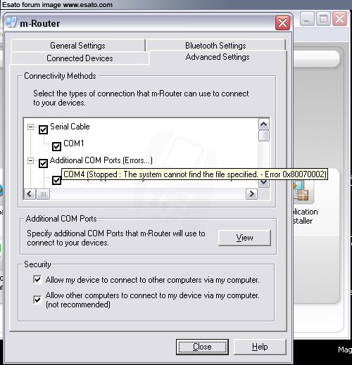

I also found this which was writen by AD
Posted: 2008-05-18 16:59
Hi Nipsen, got a new one for ya...
"Sync software, helpful pointers for when it just won't", or, "Tips for avoiding suicidal frustration brought on by repeated failed attempts to sync."
1: Plug in your phone, right click on the mrouter icon in your system tray, choose 'advanced settings' make sure USB and any sub check boxes are ticked, also view 'additional com ports', and put everything in the left box into the right one.
2: Try using a different USB port on your computer - preferably one that's hardwired onto the mainboard, and not on an expansion card or external hub.
3: Make sure that your drivers are installed correctly. To do this, open 'Device Manager' on your pc, attach the phone, check to see that no 'unknown devices' appear in the list on your computer (they will have exclaimation marks by the icons). If there are any, then try to update the drivers for these devices by pointing the 'update driver' wizard directly to C:Program FilesSony EricssonSony Ericsson Symbian 9 Drivers.
4: Install the most recent version of pcsuite - downloadable from SE's website.
BUT FIRST:
Uninstall your current pcsuite, delete all references to Sony Ericsson & the pcsuite from your registry (search from the top of the tree, as there may be some in both HKCU & HKLM), manually delete any drivers from your system32 folder (they all start with the letters 'zebr' for ease of search - make sure to get rid of the .inf files as well, again these start 'zebr'), remove any folders that are left in 'program files' (SE ones that is ).
And start again. This will at least eliminate, any question of corrupt drivers/registry settings (re: the pcsuite), as these may not have been overwritten by your new installation if they were already there. I know it's a pain, but conversely it's good to be methodical.
If this doesn't help then check your XP installation for missing dlls etc. using system file checker (start - run - sfc /startnow), you'll need your XP install CD at the ready, after doing this you'll need to run windows update.
5: Reflash the phone's firmware with SEUS - NB. ALL user data will be lost from the phone (apart from any that is held on your memory stick).
