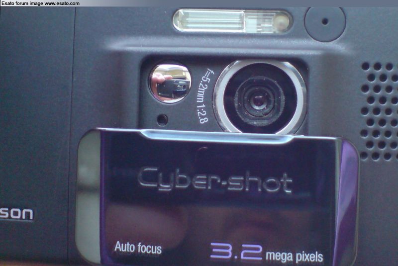

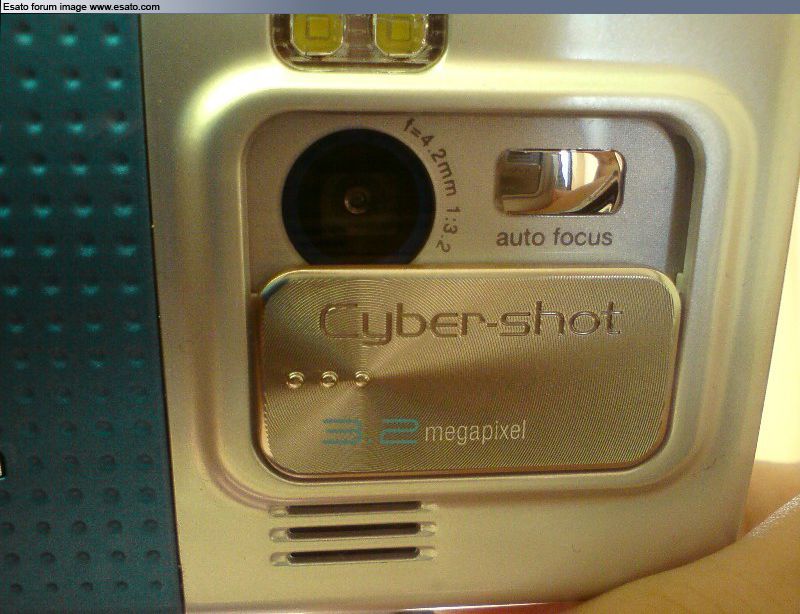

I was just browsing through the C702 pics. This pic as was shot:
C702
says the the following tag on the circumference.
f=4.2mm 1:3.2
K800
but the K800s have the following tag.
f=5.2mm 1:2.8
I want to know what is the difference in these two tags. Is it that the focal length of the K800>C702. What is about the ratio?

The ratio is the focal width, the size of the aperture.
crossmatched Joined: Jan 05, 2006 Posts: > 500 From: RP PM, WWW
C702 has a smaller (vs k800) aperture. Therefore, lesser light goes in/absorbed by the cam sensor

Bialynia Joined: Jun 13, 2008 Posts: 337 PM |
f=4.2mm 1:3.2
f=5.2mm 1:2.8
The k800i has the better, larger lens which allows in more light and will result in better pictures in lower light settings then the c702. |

centur Joined: Jun 10, 2007 Posts: > 500 From: Bulgaria PM, WWW
Original size:
bishshoy007 Joined: Dec 11, 2007 Posts: 146 PM |
Centur
Thank you for the back photo of the K800. Other users will have no confusion about the tags. But any info about it. Plz post. |
