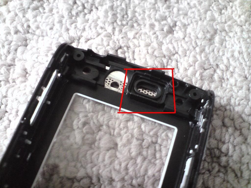

I took my phone apart to fix the screen and now I cant hear anyone on the phone. I think when took it apart the earpiece speaker fell out. I bought one off ebay:
http://cgi.ebay.co.uk/ws/eBayISAPI.dll?ViewItem&item=220286401808
But I cant see where it fits!
I can see a place where i might think a speaker goes but its a totally different shape to the one ive been sent:

On the actual front of the housing, see this pic of k800 WITHOUT:
Photobucket
You remove it from old housing and put it on new one

I know lol but same principal, pic updated on first post

Take a look at the speaker in the ebay link. Im sure its not the right one for a K770i.
I ideally need someone with a pic of the earpiece speaker in situ in an opened up K770i, or someone who has repair knowlege

So once you have the front of you're phone took off, turn it backwards (almost as if its inside out), look at the top (basically where your pic is but on the plastic of the phone), put your (hopefully genuine fingers crossed with it being off ebay though) earpiece in the slot with the golden pins poining towards you, then reassemble the phone and the gold pins will touch the gold on the phone
Let me know if you need help

What i really need is somone to take a pic of the inside of their k770i with the speaker in situ ( or out of its place) so i can compare it to the speaker i have bought of ebay.
could somone look at the ebay ad and tell me if this looks like a genuine k770i speaker?

SAme place as on my pic of k800

Most of SE's candybar phone have the same place fos it's earpiece.
Just try to put the speaker to the back of the front casing, if it didn't fit well then it means you've just been jacked by e-bay's defected items collection...
Go to 4shared and search with dismantling K770i, maybe you'll get the picture you want Mate...
