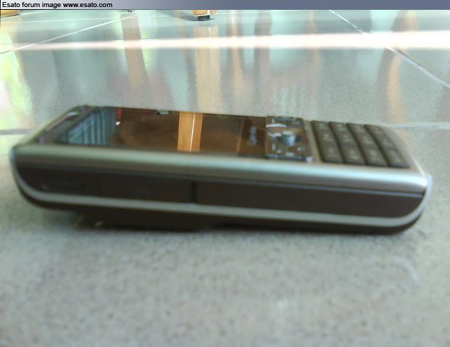

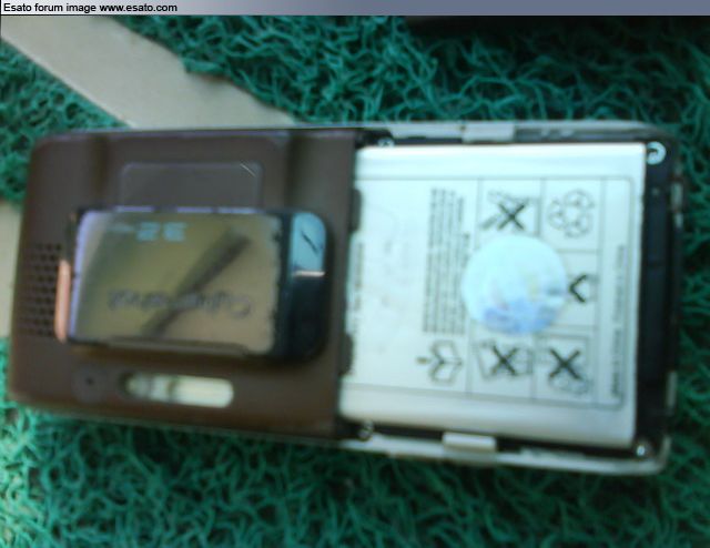

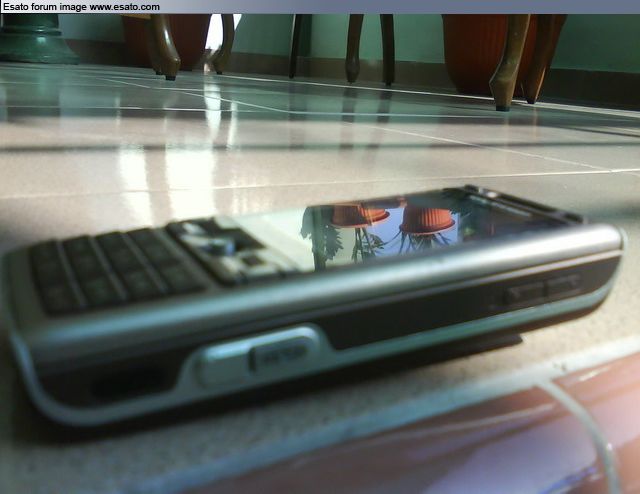

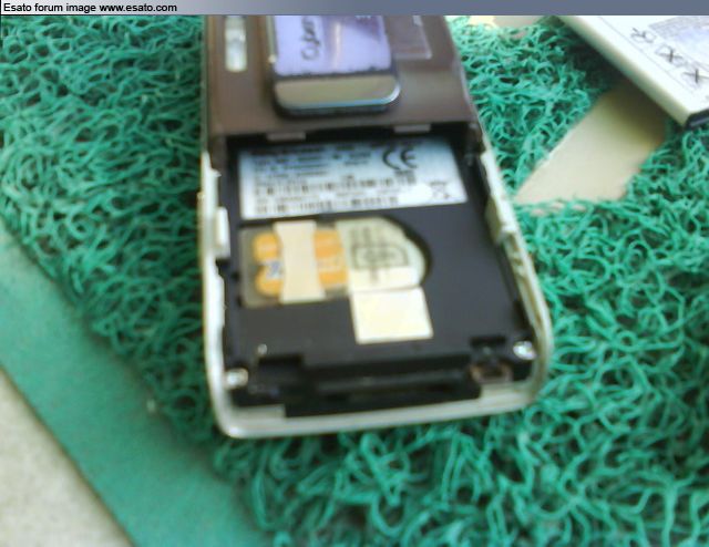

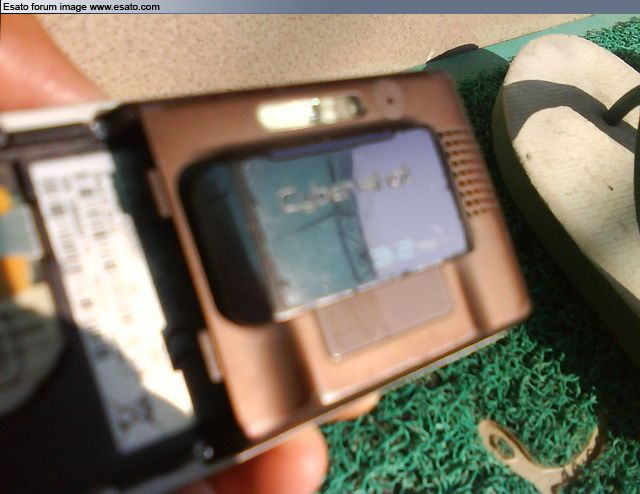

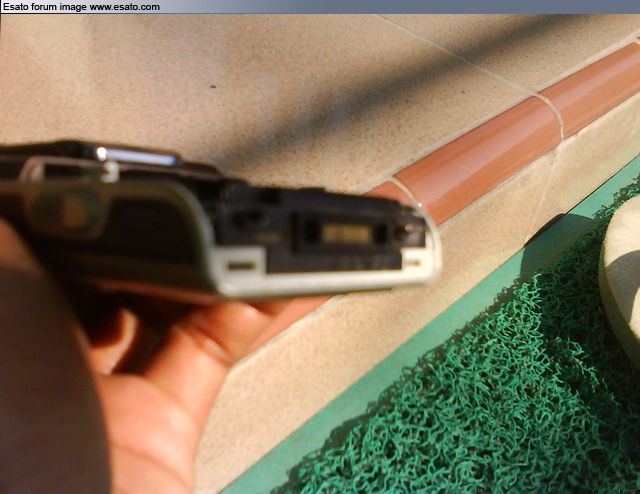

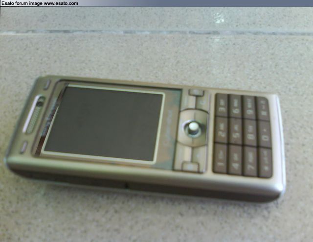

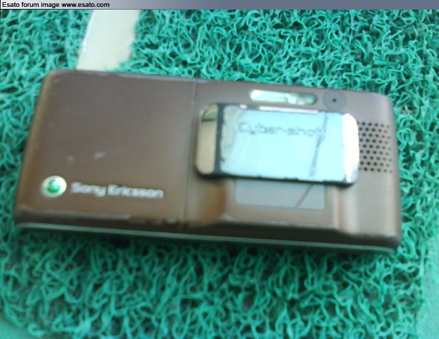

Thank u milan91, now i can use my 2nd k800. here's some picture of my 2nd phone:
