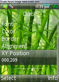

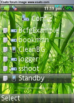

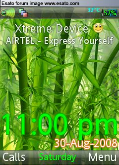

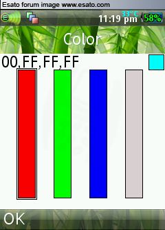

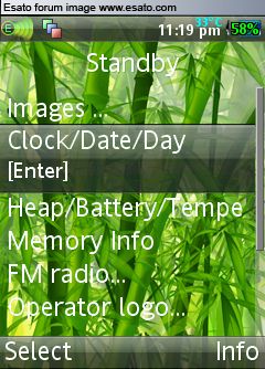

Have a look at these:
Notice the temperature at the top, the battery % indicator and the day.
You can have this too. But the process to achieve this is very long.
I tell you what to do but dont ask me for any tutorials.
1. Apply quick access patch. You require certain programs and the correct patches. Tutorial: http://www.akshayy.com/sonyer[....]ying-patches-for-db2020-phone/
2. Apply the elf lib and vkp patches. Tutorial: http://www.akshayy.com/sonyericsson/pimping/elfpackelves/
3. Install the Bcfgedit and the Standby Mode 2.0.7 elf and edit the standby bcfg file to your choice.
Here are some relevant pictures.
