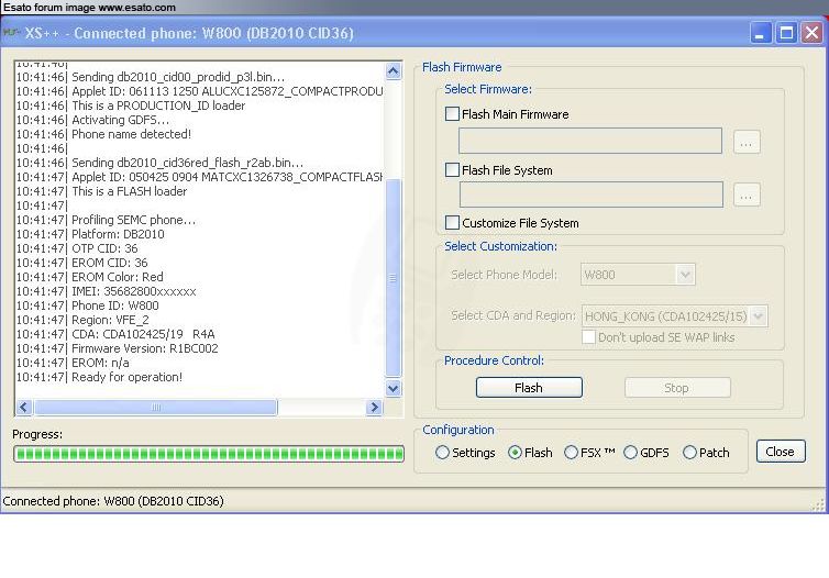

Ok first of all, my phone specs: •Se w800i •CID 36 (red) •Current F/W version:r1bc002 •DB 2010
If you need any more info about my phone here is my XS++ log:
http://www.esato.com/board/img.php?id=109410
Ok so I'm gonna use XS++(version:3.1 Darwin) to do do this flash.

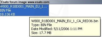

I have downloaded these two files from iprotebe to use for the flash(I'm gonna flash to r1db001):
•FS: W800_R1BD001_FS_EMEA_1_RED36.bin
Here's where I downloaded it: http://www.iprotebe.cz/downlo[....]_EMEA_1_RED36.zip-file491.html
•Main: W800_R1BD001_MAIN_EU_1_CA_RED36.bin
Here's where I downloaded it: http://www.iprotebe.cz/downlo[....]EU_1_CA_RED36.zip-file492.html
