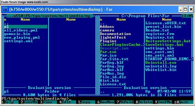

Hey 2 all, I wanna upload a new walkman skin for my SE w800i. I'm using far manager. Ok so I go into the file system(FS) then to tpa/system/mutlitmedia/mp and in that directory there is supposed to be a skins folder but their isn't, there's only this:

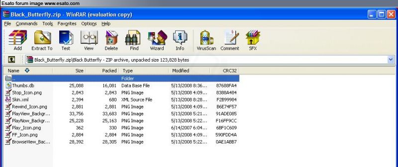

OK so where should I copy these files that I downloaded?

Not sure if it will work, but try to edit settings.xml and add those skin files instead of original. Then copy skin files to the folder.

This will work, but it is an old and buggy method... Applying the sysgfx patch and then adding the new icons in usb/sysgfx should work better (no bugs at all)...
OK but where can I get that patch?? O and by the way those to versions of the "ignore closed latch" patches are both missing a line of code, I got the right one from se nse and it works.
