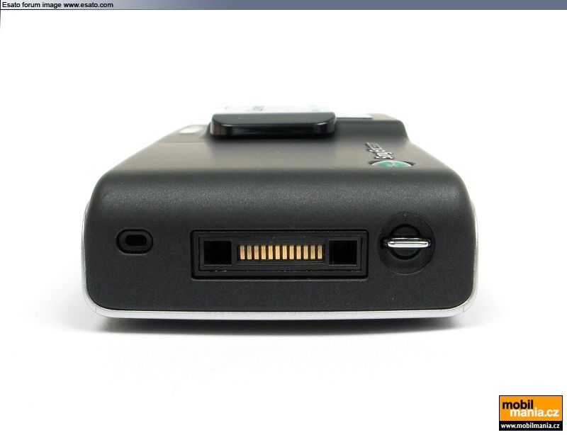

i have a problem with my phone.... the computer.. can not detect it well ... its says "unreq. usb device " ... but if i plug it over and over again.. sometime it gets the flash device.....
this is where the problem is
there are some black spots..on them...and i think the pc can not comunicate well with the phone... what can i do ?

I had similar problem like this before... I used to connect my phone USB cable to an USB hub which had VERY long wires and no external power adapter, and the phone was read 1 from 10 attempts... But, connection the USB cable directly to my PC solved the problem

HEY, I had the exact same problem and I'll be glad to help!!
Here's what I reccomend:
-First try cleaning your connecter on your phone using a need or something with a narrow tip/ use a earbud with spirts on
-If the cleaning fails try reinstalling your phones driver on your pc.
You can also try and use another cable or another phone with your cable ect. to determine whats faulty.
Hope that helps!!

I agree with this 100% the best steps that should be performed in case like yours
