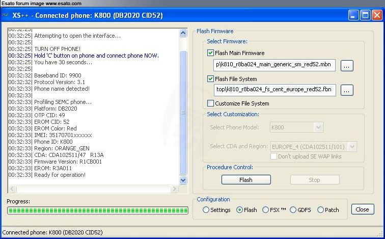

Before I press "Flash" does the attached picture look correct?
Once the flashing has finished, will my phone work again straight away?
Will all my numbers still be on the phone? Pictures? Videos? Games?
Thanks in advance for any replies. |
the process seems to be fine. BUT if you flash your phone you will lose all your data stored in the phone's memory.

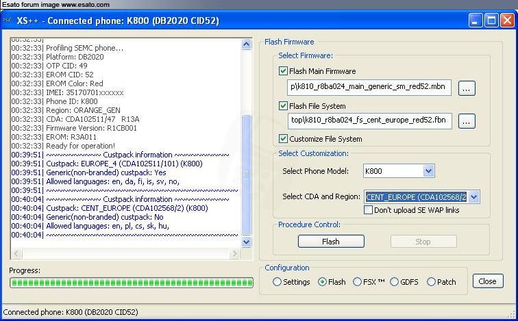

I forgot to mention the Customise File System.
Given the above conversation I was going to go with CENT_EUROPE.
If XS++ looks like this:
and I press "Flash"
Will my phone work again straight away?
What will come on my contacts, pictures, videos already stored on the phone? |
yes, the custom will work too.
mrsouthg Joined: Aug 06, 2006 Posts: 12 PM |
Do I have to do the customise file system?
I have read that you have to finish off the flashing by uploading a file structure to your phone. Correct? |
yes, you have to. if you dont you will get a Configuration Error. customize your phone after you flash the MAIN and FS.
