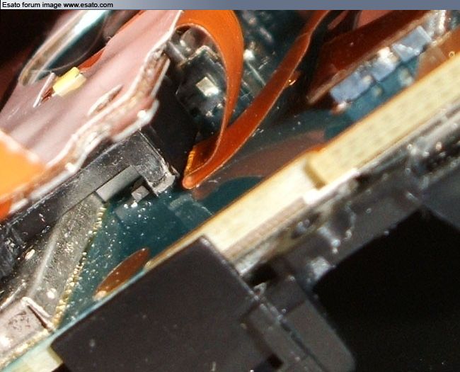

After looking at the ribbon cable more carefully I think its damaged on the crease which can be seen in this photo:
It looks like part of the plastic support seen in the picture might rub against it and have caused damage. It would explain why pressing the broken keys harder sometimes got them to work, it was nudging the ribbon just enough to jiggle it into a position where a small connection could be made. It also makes sense that other people with the same sort of problem have trouble with the same keys.
This seems like a manufacturing defect, Is it normal for the cable from the keypad to be so close to the plastic? Or is it just a faulty batch of K800i?
