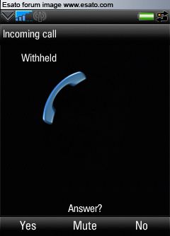

When recieving a call:
which is as it should be,
BUT, when calling, I get this:
What I want is the background of the seccond to be as the first, and what I get seems to be from the preloaded 'silk' theme as far as I can tell.
EDIT: I've just tried a couple of the preloaded themes and it seems to happen with them all, also this has been constant, no matter which firmware is loaded.
[ This Message was edited by: AD on 2008-03-31 17:35 ]
