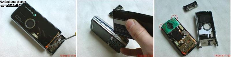

The Sony Ericsson K850i has had a fault identified by the majority of its users, with Dust issues and dust getting behind the lens cover.
I have developed a 'fix' of some sort - which I thought my be useful for some of the K850i users out there!
The body of the phone was opened, and the rear of it exposed, from where I removed the Glass lens cover which sits over the actual camera lens cover. It looks correct now, and is more like how the K850i should have been, not with a cover, OVER the cover - I have attached a picture to show the result - I hope this helps!
where is the picture you said you attached ???????
was it hard to break up the side front ?????
what did you use to clean of the dust with ?? (a fibercloth maybe ???? vacum cleaner ????

Sony α Joined: Dec 23, 2007 Posts: > 500 From: LDN/TYO PM, WWW
Hey Guys,
The phone was very easy to open, I used my Credit Card, although any plastic card will do the trick - and no, I did not use anything to clean the Glass, I actually removed it - so there is no Glass cover!
It seems to have improved my photos - So thats an upside!
Plus, I have been a Sony Ericsson user (and keen mechanic!) for a long time - just be careful not to crack the back surface of the phone.
Good Luck! |
Well Guys,
It has been a day - and my GlassLess K850i is fine, no dust specs (obviously), no damage to the auto lens cover, no issues whatsoever.
Removing the Glass Lens cover was easy, it is just attached using a ring of sticky adhesive - just a bit of force loosens it easily. It can be replaced easily too, if you want to!
No im not crazy lol - I just thought it was poor engineering from Sony Ericsson which led to the dust issue - so I fixed it myself!
You dont have to break anything in order to remove the Glass Lens cover, just pick it off. It looks more authentic this way - and now I am waiting to see Sony Ericssons next FW update, which will hopefully, fix the issue with the poor colours from the camera - ie Reds being painted a horrid pink colour and so on. |
