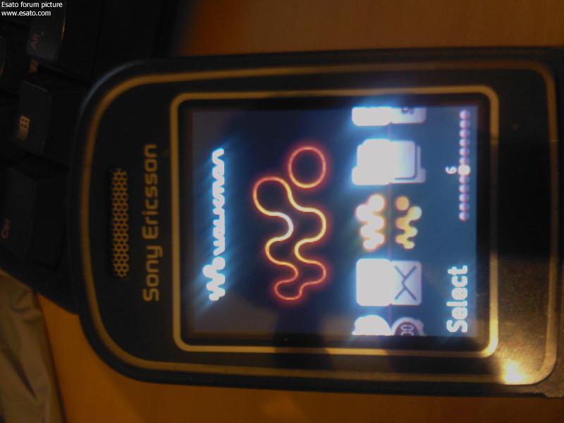

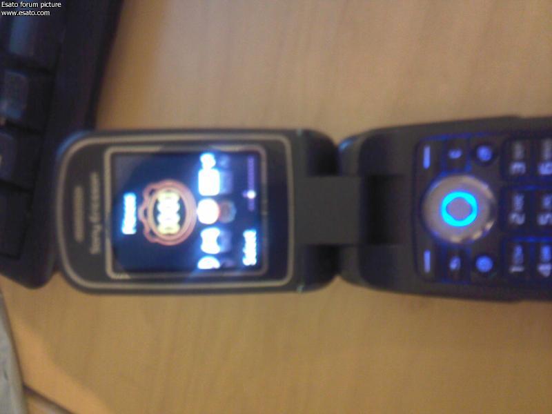

helloweeny Joined: Nov 17, 2007 Posts: 12 PM |
Well here you go with the pics.
[ This Message was edited by: helloweeny on 2008-01-03 19:46 ] |
