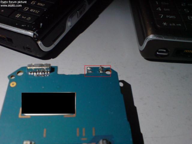

actually there are 4..the piece that came off was sort of like a square so 4 points left. Can you please be more clearer on the method u used, not sure how the screwdriver completed the circuit, if possible could u make me a diagram using paint or something, i would really appreciate it!!

You just put the screwdriver in onto the contact points left to complete the circuit, and the phone should turn on. It might take a few attempts, but should work in the end. Just don't turn the phone off if you can help it or you'll have to go through the rigmarole again!

ok so basically, i open the phone housing, stick a screwdriver on top of one the points? but which point of the 4? and any screw driver will do? uve been really helpful..btw i have 5 years of warranty (3 years left of it) on the fone, will that help?

i also happen to have a k700i with a broken switch (and water damage) that i have stripped down and never bothered to fix.
I think the switch is the bit highlighted in the red box and Sammy_boy is telling you to put the screwdriver over those pins. (they are on the screen side of the phone)
The photo is pretty poor quality as i couldnt get my k810i and k800i to focus properly (wheres my k750i when i need it! )

so one screwdriver to cover all those pins or 4 screwdrivers for each pin (the first choice seems more logical lol). thanx

I TURNED IT ON...The screwdriver method worked..thanx alot guys, I really appreciate it, god bless u all!!
