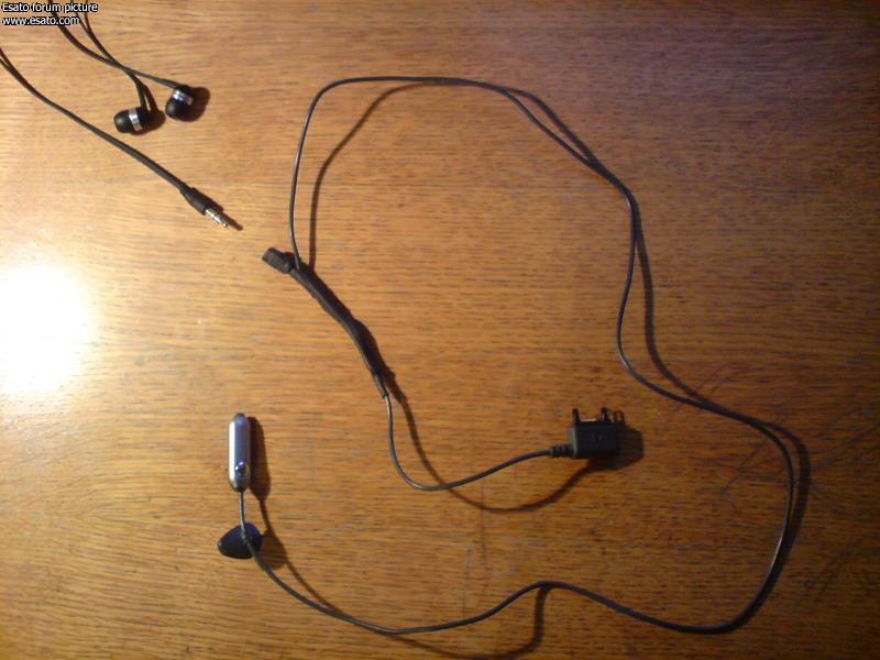

Building something yourself should be pretty simple if you have an old K-series handsfree kit, a 3.5mm stereo jack, and a soldering iron.
I was totally fed up with the earphones on my original SE handsfree kit, so I added a jack for my own earphones. However, I wanted to keep the handsfree functionality, so it is not quite as simple as your case. If I remember correctly, these are roughly the steps I took:
  • Prised open the microphone housing on the handsfree kit
  • Desoldered the original headphones from the circuit board, and made a note of what colour the wires were that carried the signal. (Blue and green, can't remember which channel was which)
  • Closed up the microphone housing again.
  • Cut the cable a few inches up from the phone connector.
  • For once in my life I remembered to slide all the heatshrink tubing onto the wires before I started soldering!
  • Soldered the white and black (microphone) wires back together again so that the microphone would work on the handsfree kit.
  • Soldered the blue, green and ground wires to an old 3.5 mm jack I had lying around.
  • Used loads of heatshrink tubing to make everything nice and snug and secure.
It doesn't look the prettiest, and I guess my soldering won't last forever. However I'm so much happier using earbuds that actually stay in my ears, and finally hearing my music properly at last!
