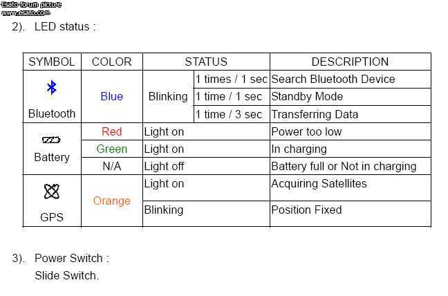

its always blinking (though at different rates)
here is the table of led statuses from the manual

Ahhhh right, ok well thats the light thing sorted, dont think im ignorant - no manual with it and couldnt find it online so thanks for that. Its blinking every 3 seconds using Amaze program so it does work i think, just the program is rubbish.
