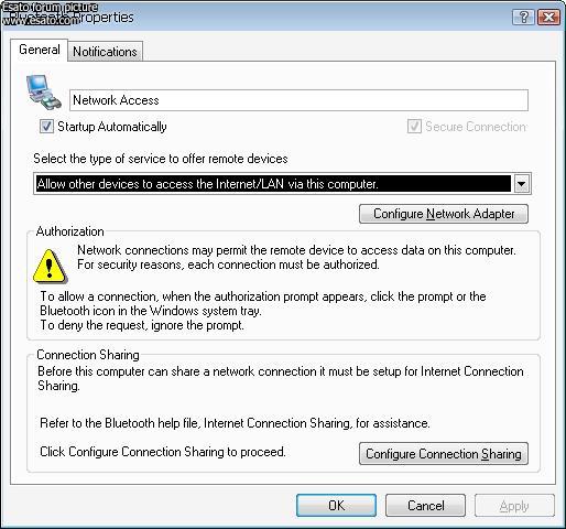

You must have the broadcom/widcomm software to make this work, so
Click the bluetooth icon in the notification area and select 'advanced configuration' click on 'local services' and click on 'network access' and click properties then select allow other devices to access internet:

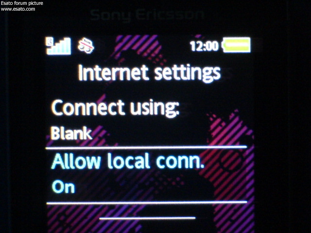

Pair the W910i with the computer, now on the W910i got to 'settings' 'connectivity' 'internet settings' what I did here to stop the phone using the phone internet is create a dummy account with no settings in it so the connection would always fail. Then go to 'Allow local conn.' and put that to 'on'.

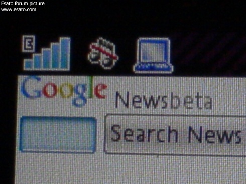

Once the phone is connected there should be a small computer logo at the top of the screen of the phone, thats it the phone can now use the computers internet connection, you won't be able to go to your network providers homepage but you should be able to go anywhere else.
There shouldn't be a globe icon at the top of the screen when you're using the computers internet:
