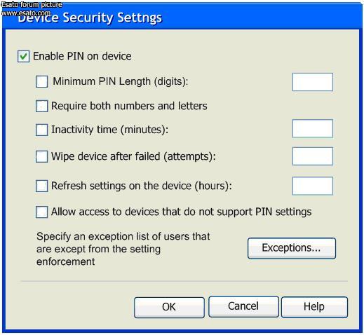

Lord_NiCO Joined: Dec 24, 2002 Posts: 3 PM |
Have you tried to change this setting on the Exchange server?
"Confirm with your IT staff that device security settings on the server allow access to devices that do not fully support password settings. This option is available in:
Exchange System Manager > Global Settings > Mobile Services > Device Security
If this checkbox was unchecked, you will get a a connection failed, although a Windows Mobile device would still sync properly."
This due to that K850i only supports the following security features:
Wipe: PIM data and settings are supported.
Exchange 2003 Device security Settings: NOT supported.
Exchange 2007 Additional Security settings: NOT supported.
[ This Message was edited by: Lord_NiCO on 2007-11-02 13:59 ]
