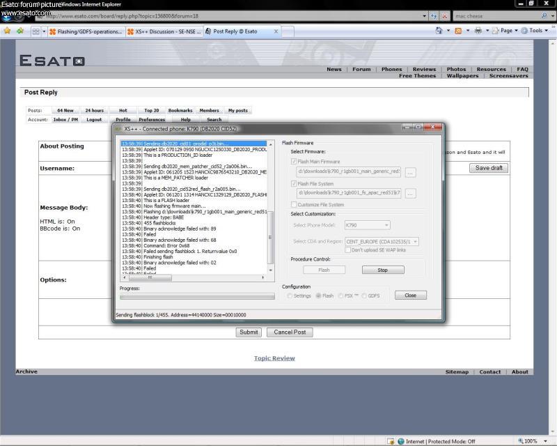

I tried using the xs++, and it failed when i was flashing the firmware. I tried copying the log but it didnt allow me to copy it, so i took a screenshot instead

could you give a try with another firmware version? probably that doesnt work.
