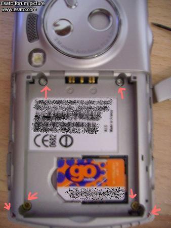

First i removed the battery and unscrewed the following marked screws.

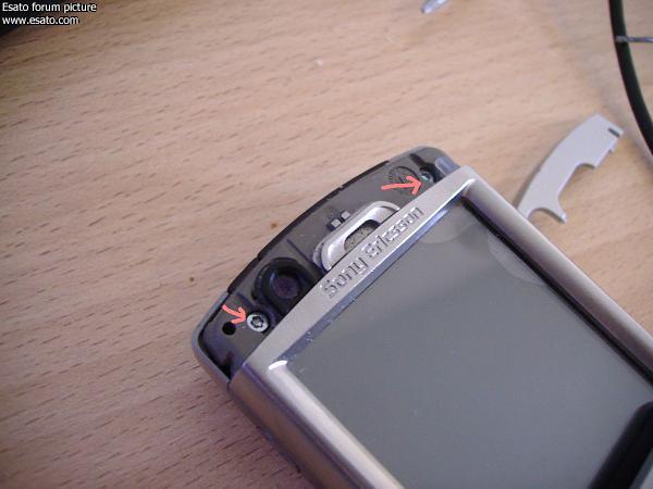

Then removed the front cover above the screen to reveal 2 hidden screws, removing them too..

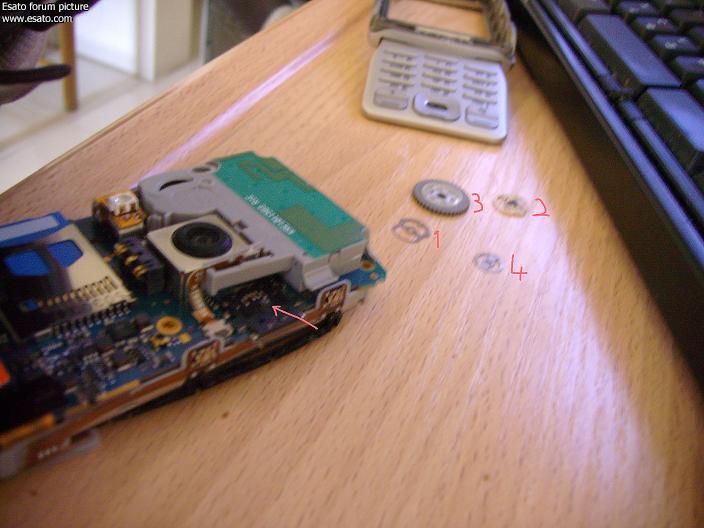

This is the wheel disassembled.
Note that the parts fit on top of each other in order from 1 to 4 onto the pin where the arrow is. part 4 is the part that creates the clicking sound against the wheel as it has a rectangular hole in middle where the pin fits into it when putting it together, keeping it from rotating and creating the clicking against the wheel. I found out the play i was getting when rotating the wheel was the actual pin rotating a little when changing the wheel's direction when apparently this shouldn't budge. I suspect some notch on the top of this pin has worn down so the parts don't stay together, as soon as i move the wheel part 4 comes off. It seems like a wear and tear issue but after 4 months?! is this something phone shops can fix or should i send to SE? We do not have SE people in Malta (where i live).
