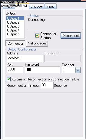

Open winamp
Go to option, preferences
On the left, Plugin, DSP/Effects, double click in the SHOUTcast plugin
Click in output tab
Check connect at startup
Adress: localhost
Port:8000
Encoder 1
Encoder tab
Here you can do some experiments on your on, changing it to a better or worse wuality. To start lets choose 48kbps 44.1000 Mono
Go back to output tab and click connect, the you should see the timer going on
Now start to play something in winamp and you should see the bit count going up, leave it like that. You should see some errors about yp.shoutcast.com, just ignore it.

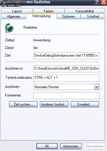

Step 3 - Creating the HID profile to start everythig through the mobile
Get the desktop.hid and list.bat from the helpful link on the begining of this post, open it with the default hid editor from SE. Select any button fo your choice to L Alt + L Ctrl + 1.
Run the list.bat and look for radiobee, write down the ID and entrypoint.
Now create a shortcut on the desktop to the ejava.exe inside the SE SDK (normally in C:/SonyEricsson/JavaME_SDK_CLDC/OnDeviceDebugbin) and modify the shortcut target to "C:SonyEricsson/JavaME_SDK_CLDC/OnDeviceDebug/bin/ejava.exe start ID entrypoint s" don't forget the ending s for the serial network
and the key combination to ALT + CTRL + 1
Now send the bluetooth profile to the phone (right click send to: bluetooth devices) then the phone will ask to install it for you.
Now you can go to entertainment (in your mobile) and select your new bluetooth profile. Then you will connect to your pc and now you press the key you choose before on the HID editor to start the radiobee application. Choose the stream you added before and the tunes should start playin'!
