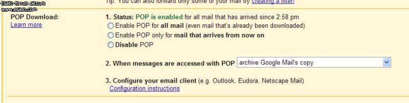

Maybe it this setting in your Gamil account.
Try checking if this is set.

Hi simpson
Thanks for the hint. But was it something specific you had in mind with the screen shot. Obviously to be recieving pop email on my W850i I must have configured gmail's online configuration for pop mail, but the problems not recieving its specifically keeping the mails as per my original post.

The picture was suppose to show the setting that says 'when accessed by POP the emails are moved from Inbox to Archive'. Wondered if this was what was happening.
