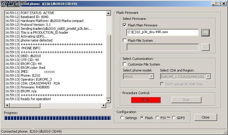

5) Download XS++ at and K310 tested ssw at K310 Tested SSW (was tested successfully by me) and extract the file to your preferred area. Run XS++ press start, Turn off phone and hold c and connect cable.
6) Tick Main Firmware and open k310_p3k_dcu.49R.ssw then click flash. Wait for 5 flash blocks and click close
