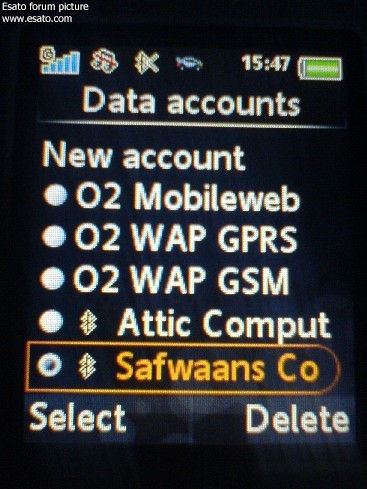

On my W710i if I go to 'Internet Settings' then 'Internet profiles' select 'new profile' and then click on 'connect using' it lists the different access points one of these access points is my bluetooth computer:

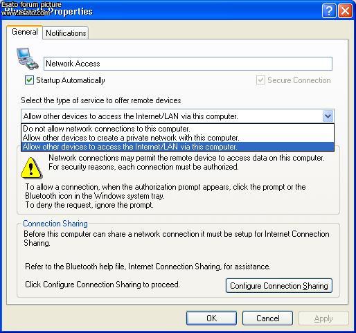

Then on my computer if i right click the bluetooth icon in the notification area and select 'advanced configuration' click on 'local services' and click on 'network access' and click properties then select allow other devices to access internet:

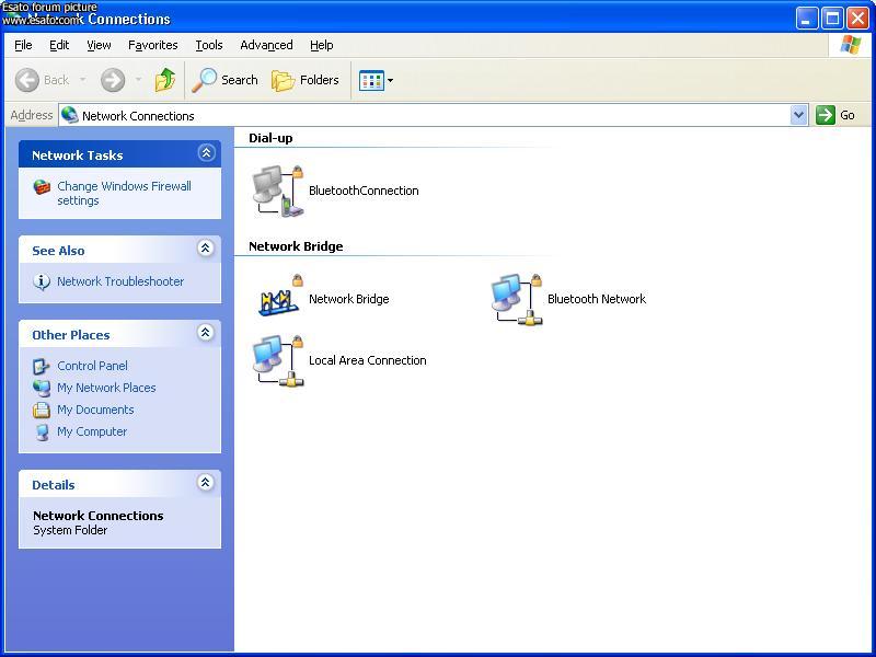

And the final step is to bridge the Local area network connection with the bluetooth connection in the network connections menu:
I know it seems a little difficult but it was really easy and i didn't have to install anything.
