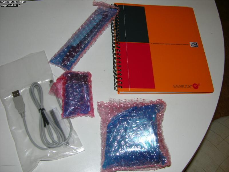

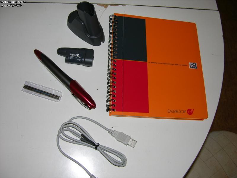

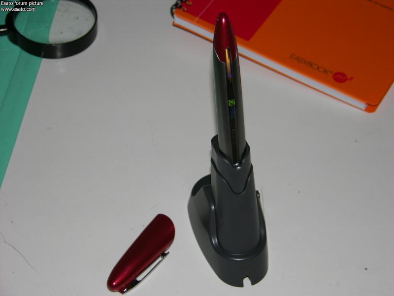

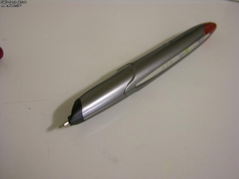

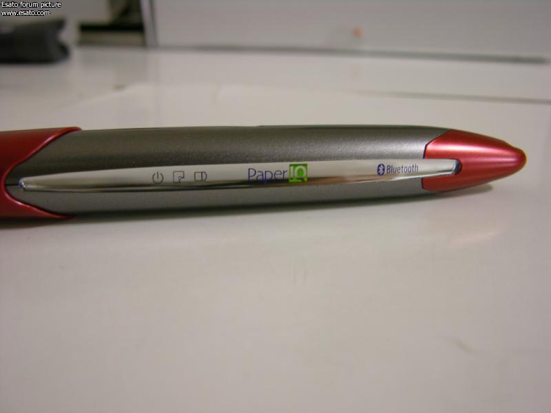

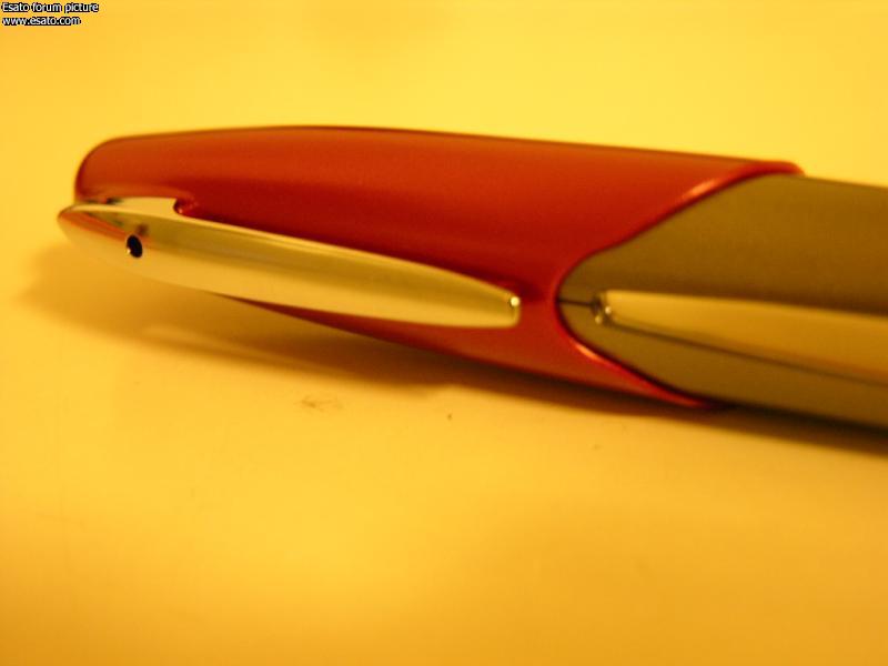

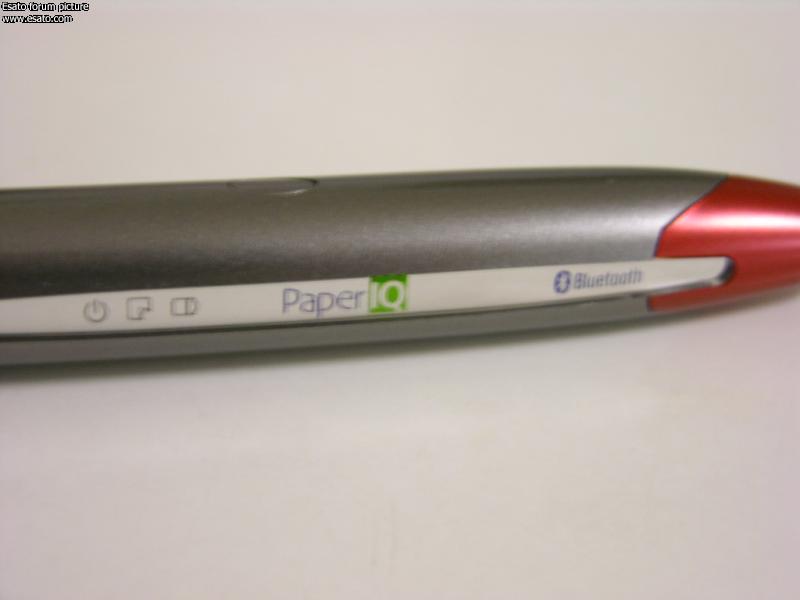

Here are some images of what is supplied with the pen kit and images of the pen:

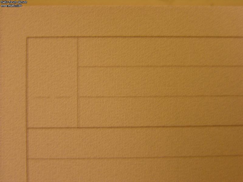

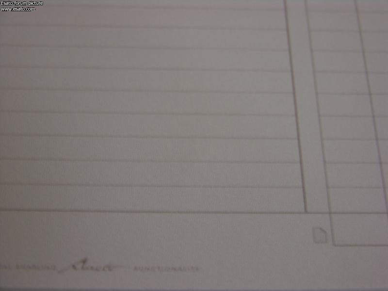

And here is how the paper looks (notice the very very small dots):
Paper can be bought at your local store (Svanströms in Sweden for example) in the form of a A4, A3 or pocket sized notebooks by Oxford called Easybook M3 (http://www.oxfordeasybook.com/en/easybookm3.htm)
