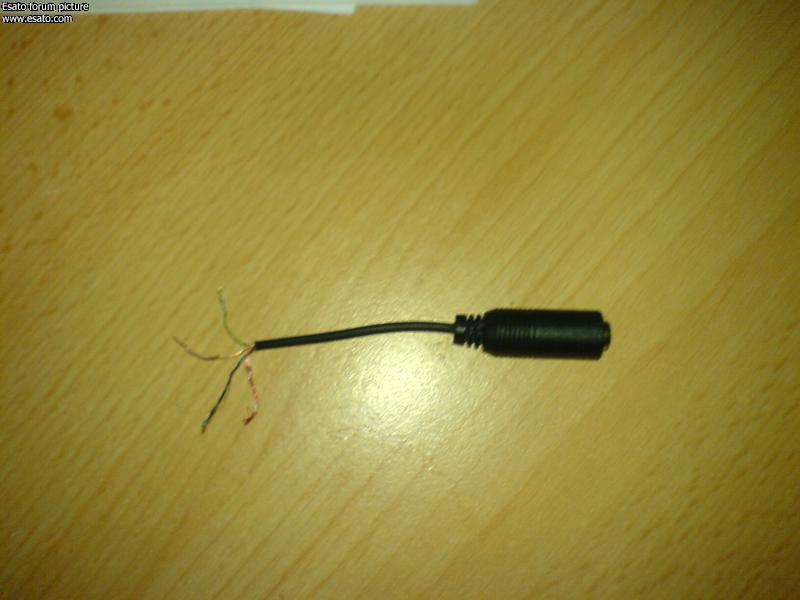

Hey there ive got a SE K750i and i wanna mod the head set into a ear jack to plug my own headphones into it,
The reason being is because my stupid mutt of a dog bloody chewed the original earpeices .. i wasnt happy at all.

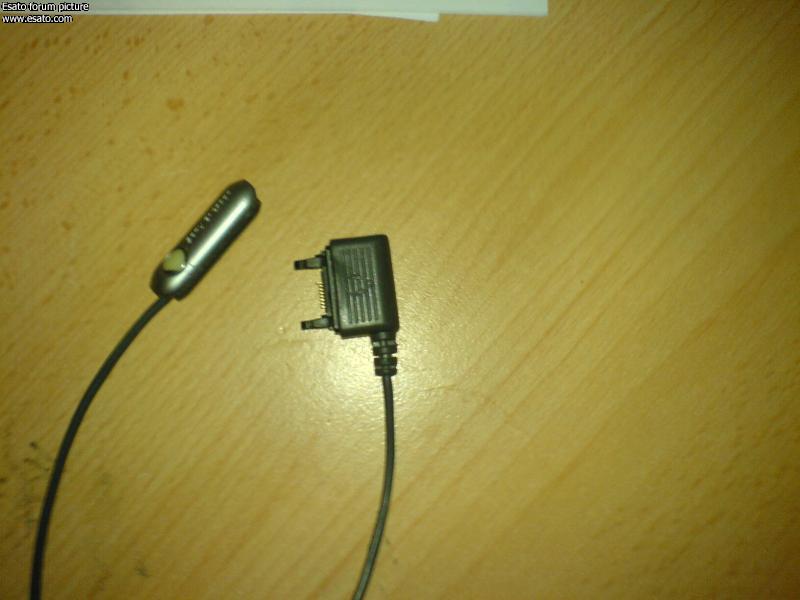

so i bought a ready made earphone jack of ebay for 99p and after a day of usin it, the wire coming out of the fast port came out and i dont know which pins go on what wire. so i broke down my HPM70 head set and wanted to wire the broken earphone jack straight up to the head set but ive tried connectin the same wires together and i get no sound?

opexblue Joined: Jan 18, 2006 Posts: 226 From: Manado, North Celebes, INA. PM |
The wire is covered by email layer. you have to remove it by scratching the wire with something sharp (e.g. knife, etc.), till it change colors to copper color . Then you connect the same wires together.
