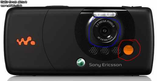

@BLKSNAKER
The part that's circled in red is the self-portrait mirror, and the one circled in blue is the actual camera lens. No lens protector.
If those are not the parts you were talking about, then what do you mean?

The blue circle shows the protector of the camera lens, and below it the camera lens itself. Look...make AF work and take a look at the zone indicated by the blue circle: the mobile part is the camera lens, and the static plastic on it,the one you can actually touch,is the camera lens protector. Do you see it now?

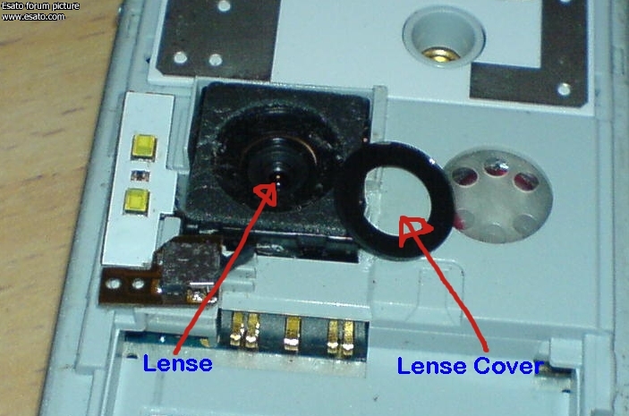

The confusion comes from the fact there is no clear naming convention for the various components.
When people say Lense Cover, they invariably mean the sliding Active Lense Cover, however there is another lense cover. The other lense cover is just a small round coated piece of see-through plastic stuck to the outside of the camera module itself. This protects the lense inside. some people wrongly assume this flat piece of plastic is the lense, but it isn't.
So on K750 et all, you have the Active Lense cover, then the Lense protector (also a lense cover), then the lense.
On the w810, you only have the Lense Protector and the camera lense underneath that.
This picture of a K750 shows the lense protector removed and the camera lense underneath:
The camera module on the W810 is identical, so the same should apply to the W810.

Posted: 2006-08-23 04:48
just prise it off gently with a small jewellers screw driver or similar. It's only glued on, the glue will restick so don't use new glue, it might just muck things up
