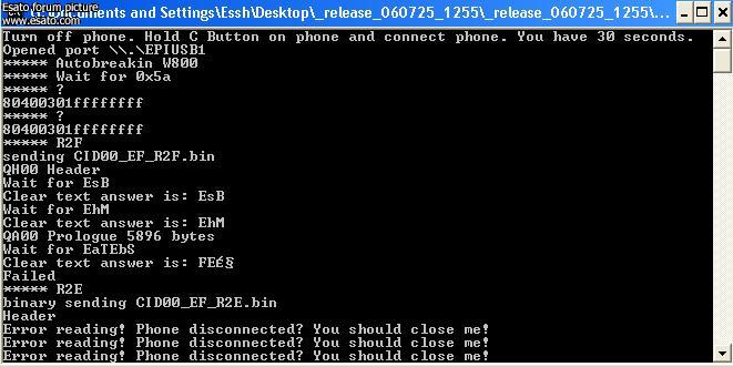

Essh
Joined: Aug 21, 2006
Posts: 2
Posted: 2006-08-21 21:35
THis Erorror messge is also am gettin
What is this I cant understand i have treind alots about 20 times
Tigerente
Joined: Nov 21, 2004
From: near to Kiel/Germany
Posted: 2006-08-21 21:59
Seems that your phone is CID49. w800.exe is only suitable for phones up to CID35.
CID49 (new k750i phones) isn't possible to change for the w800.exe update.
