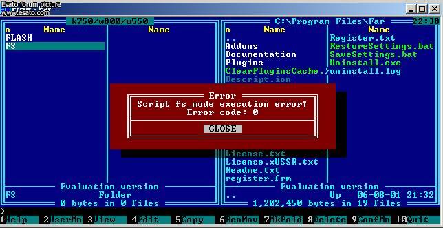

I was trying to remove the SMS limit on my W800i using Far Manager and Darkmens flash plugin ( http://www.esato.com/board/viewtopic.php?topic=123260&start=0 ). I could connect the phone to the computer just fine but when trying to open the FS-directory I got this error message: "Script fs_mode execution error! Error code: 0" (se picture)
I'm using Far Manager 1.70 (couldnt find 1.705 anywhere) and the Davinci flasher showed that my phone is CID36:
Phone Color: Red
Phone CID: 36
Firmware Version:R1L002
Phone Model (2):W800i
W800 recognized!
I was following this guide:
http://www.techenclave.com/fo[....]limited-sms-storage-77054.html
I have tried both sefp08093 and sefp09038 with the same result.
Anyone have any idea what could be wrong?
Thank's in advance.

Just wanted to let you know that the new version of the plugin (v0.10.0.44) fixed the problem, the plugin can be downloaded from:
http://sephone.nm.ru/tools/SEFP010044.zip
