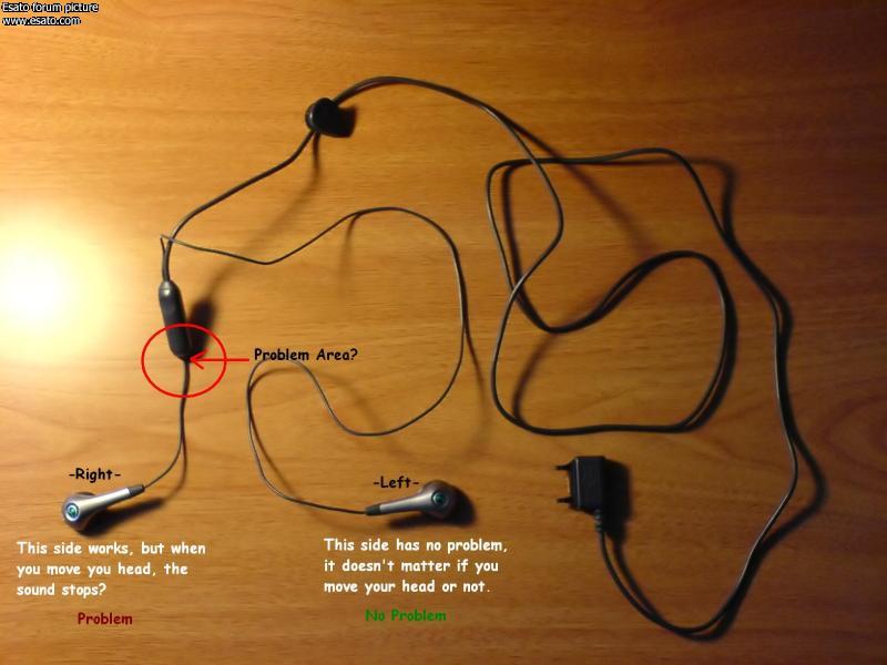

The stereo headset that came with my Sony Ericsson K750i is breaking? When I use it, the right speaker doesn't work ( no sound- or with static ). When I move my head sideways or shake it, it works!- until I move it back. The left side has no problems, theres sound- no matter where you turn your head.
RED Circle- I think that area is where it has problems. The area where the wire and the microphone connect. When I touch it, it works. Is there any way I can fix this?
Thanks, KLG2992- Kevin

OK the problem it is not that big if you have some moulding skills.
the same happened to me once and I opened the place where the microphone is, cut a little of cable and that was all.
But if you aren't good or don't want to mould it you can always get someone to do it for you

I had a similar problem once. With sound only coming through one ear piece, however in the case of mine all it appeared to be was a dirty conector. As after wiping it with a alcohol wipe it all work well.
