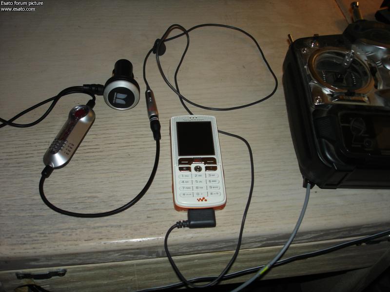

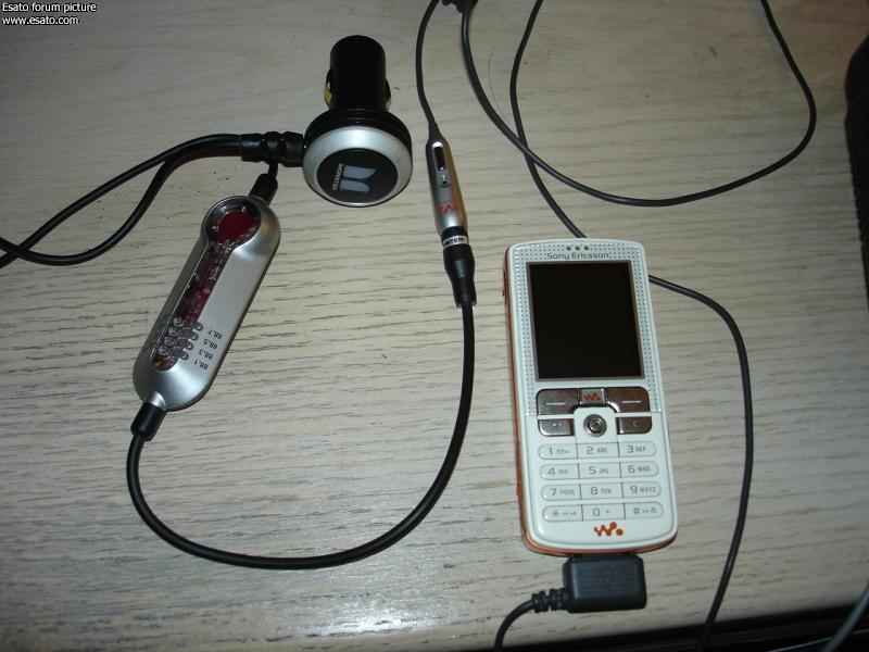

I have a different solution. Buy a Monster radio transmitter from RadioShack for $40 plug it into your cigarette lighter, tune to your preset channel and enjoy. Little more expensive and probably somewhat lesser quality conection than wired ones, but I don't like to order and have to wait for things. When I want it, I want it right now:-)

george:
fm transmitters are good and easily accessibly. however, if your ears are as sensitive as mine, you'll notice a huge difference from directly connecting to your stereo.

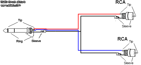

i want to share to you how to make a good alternative for mmc-60 se music cable.
first, you must have an adapter like the one that comes with W800i package (hpm-70 adapter) or any 3.5mm stereo adapter (most have no built-in mic).
then, secure at least (2) mtrs. stereo cable or any length you wish, (1) 3.5mm stereo connector and (2) RCA jacks (red & black).
Below is a sample of metal 3.5mm stereo connector.
then, connect/solder the 3.5mm stereo connector and 2 RCA jacks to the stereo cable at both ends as illustrated hereunder.
(remember: if you can't make it by yourself, this 3.5mm to rca stereo cable is always available in the market just buy it and plug it to your hpm-70 adapter rather than buying a new mmc-60 music cable! but, of course, its having a lot of fun if you can invent it by yourself!)
hope this could help you guys.
