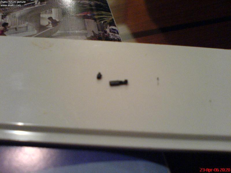

Thanks for the help, the camera now is always on.
Basically i have used a toothpick to turn it on. The whole plastic has come off and thus i just pressed a bit the hole with a toothpick and the camera is always on... I 've found the plastic
Thanks again!
these are the two pieces of the plastic...
