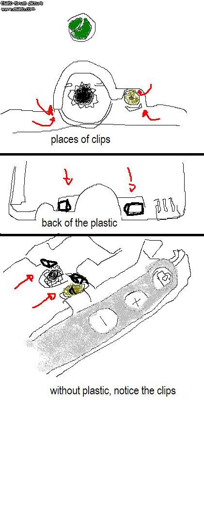

mcrosser
C901 Black
Joined: Oct 11, 2005
From: Peru
Posted: 2006-04-16 03:08
I've opened my T630 a couple of times. the screws are four: two at the bottom, than taking of the top plastic you see the other two. I can unscrew them at an 80º angle if you get what I mean, without having to take of the antenna. than with something like your nail, pass it through the sides and the front cover comes off, leaving the screen unveiled ! I usually open it to take out some dust. hope it helps, cheers.

mcrosser
C901 Black
From: Peru
Posted: 2006-04-16 03:32
heres how to take off the plastic covering the antenna.
done on paint, hope you can be guided by the images. to take out, use your nails to take it off place, than slide upwards. notice the power buttons comes out. cheers.

mustafabay
Xperia Mini Pro Black
Joined: Sep 27, 2004
From: Egypt
Posted: 2006-04-16 20:46
So there are clips? Like push them down and slide back and that's it, or push and get your pet elephant to pull?
Never mind its off, its off, off it is, its hard to type while bouncing off the wall
Now the antenna Help?
